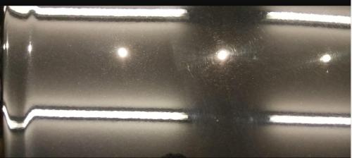

Here's a 50/50 shot of when I used that compound. Honestly was good enough for me not to use a finishing polish
