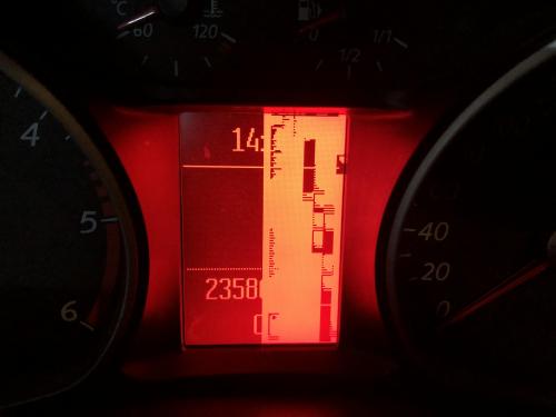

This is what my cluster display looks like on my 2007 S-max. Could it just be a loose connection, or do I need to replace the screen/cluster?
I hate the red anyway. So I'm hoping there's some fancy replacement cluster that I can just drop in. Any ideas?
Also possibly relevant: Trouble codes U3001 and U0126, both control module comm failures

I'm currently investigating this problem. It is either a bad connection in the LCD itself or on the PCB.
The LCD is not soldered on. Just 2 flat cables (ZIF FPC).
