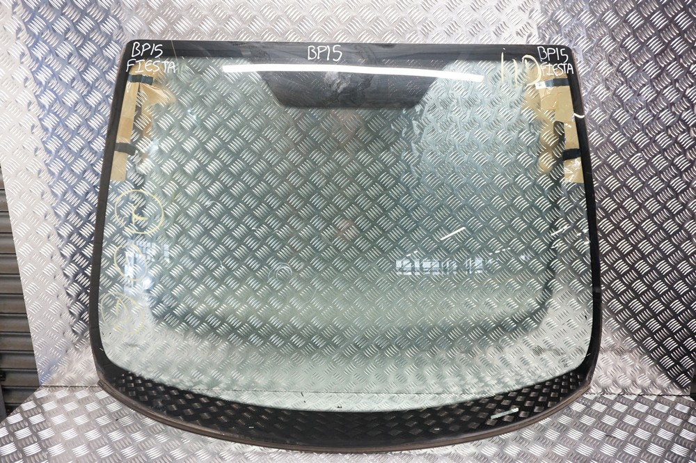

well actually it isn't the non rain sensor windsceen doesn't have the gap in the black silk screen for the rain sensor and as such the rain sensor will not work
FORD FIESTA MK7 FRONT WINDSCREEN GLASS (RAIN SENSOR VERSION) 2013-2017 NJ15  – Gala Motors FORD FIESTA MK7 FRONT WINDSCREEN 2013-2017 BP15 – Gala Motors
Picture on the right is the non auto headlights windscreen, the one on the left is the auto headlight windscreen.
You will need to replace the windscreen, get the rain sensor, the column switch with the auto wiper position, and the light switch with the auto lights position otherwise the car will give a dtc about it as you can't enable the auto lights in the central config without enabling auto wipers.
