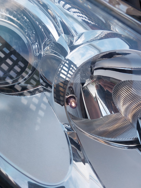

Having trouble with the side lights on my 2011 Fiesta. Both bulbs each side are dull, dipped beam and headlights appear to be fine however. Tried changing bulbs with the same ones but the same... Any ideas? 🤔spacer.png

Many years ago I had this problem on rear lights on an Orion. Turned out to be a corroded earth on the rear light circuit. Cleaned up with a bid of emery and was fine. Looking at age of your car could be the same problem.

using these and they arnt so dim
https://www.halfords.com/motoring/bulbs/501-w5w-3500k-whiter-car-bulb-halfords-advanced-twin-pack-718761.html
if you want really bright then try led ones. i had the ceuk brightvue ones and they lasted about 7 months and the warranty was 6 months.
