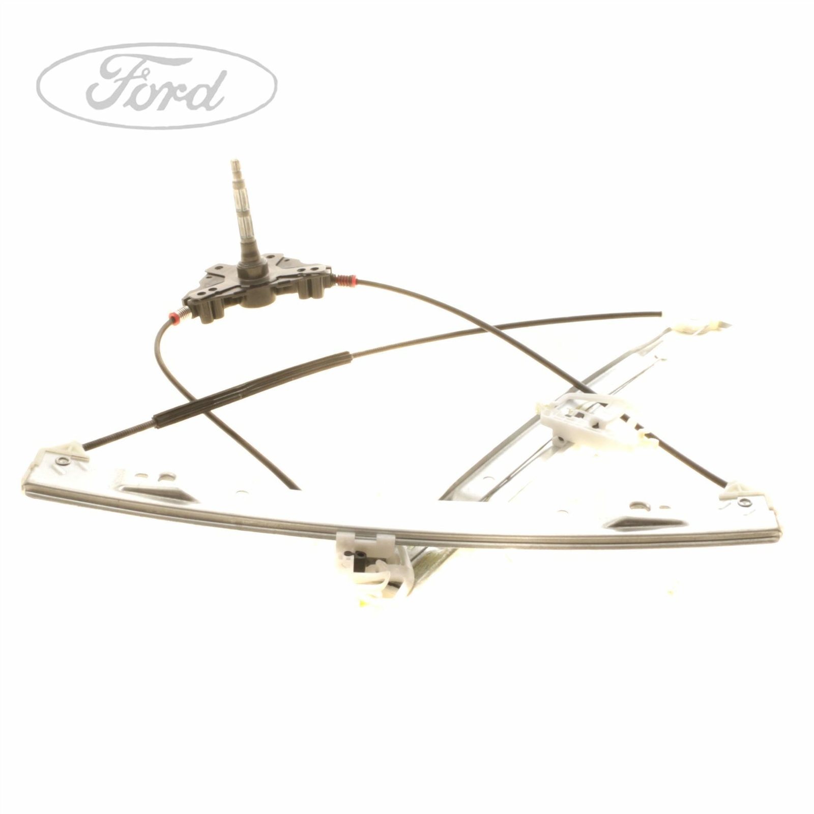

The cable regulator on the Mk6 Fiesta/Fusion operates in the same way for both manual and electric windows.  The only difference is the winding handle in place of an electric motor.
You'll most likely needs a replacement regulator.  These are sided and 3dr/5dr specific.  Very expensive new but also quite rare used as very few of these had manual front windows, only the most basic ones!
I can't find a 5dr RH (right hand) regulator on ebay at all.  But this is a 3dr one just for visual comparison.
Picture 3 of 4
Picture 1 of 4
Picture 3 of 4
Picture 1 of 4
