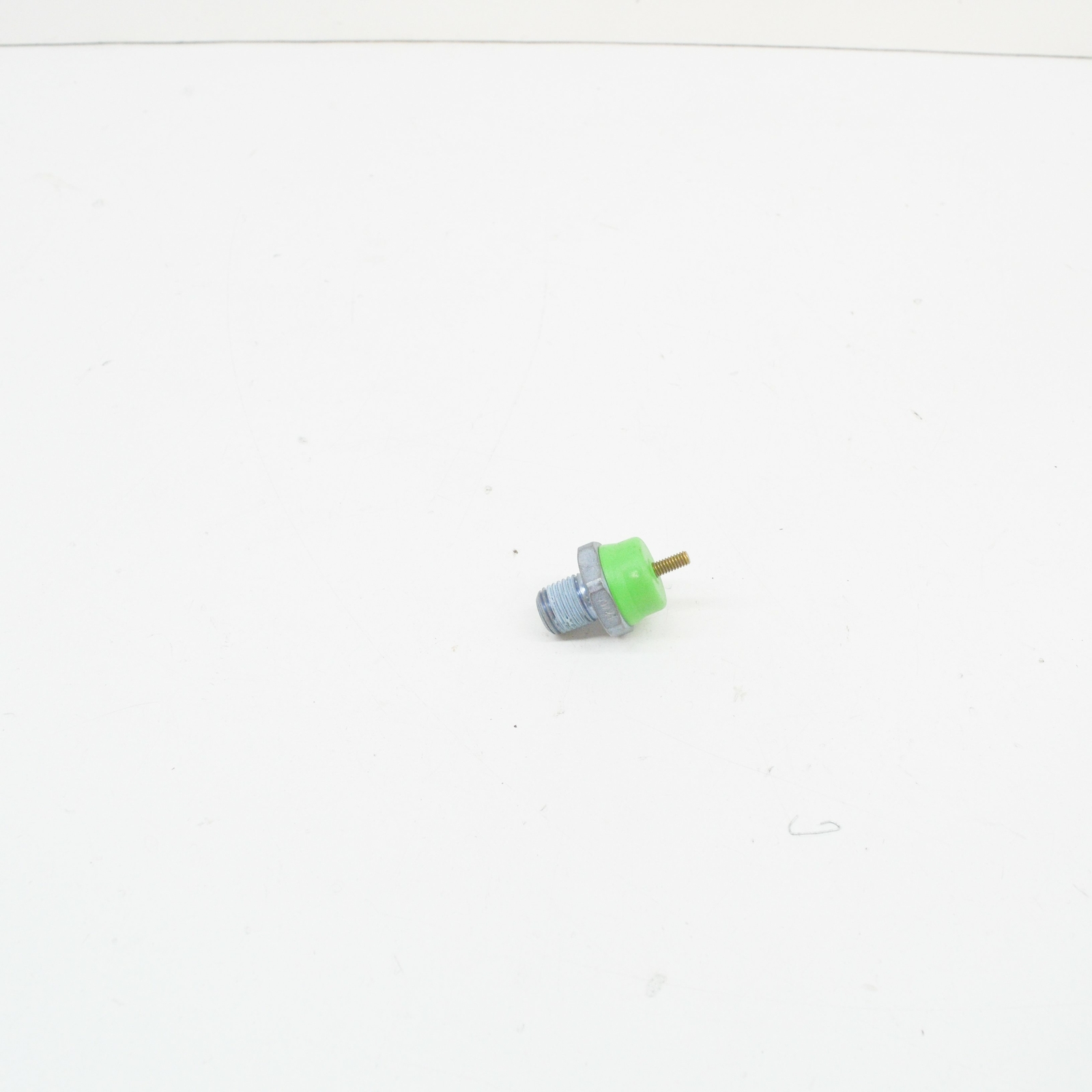

That's the oil pressure switch.  Very easy to replace, pull off the single wire, unscrew old switch, screw in new switch, refit wire.
Here's a link to the exact same part, but cheaper aftermarket ones are available.
FORD FOCUS MK1 Oil Pressure Switch Assy 98FB-9278-AA 1027970 NEW GENUINE | eBay
