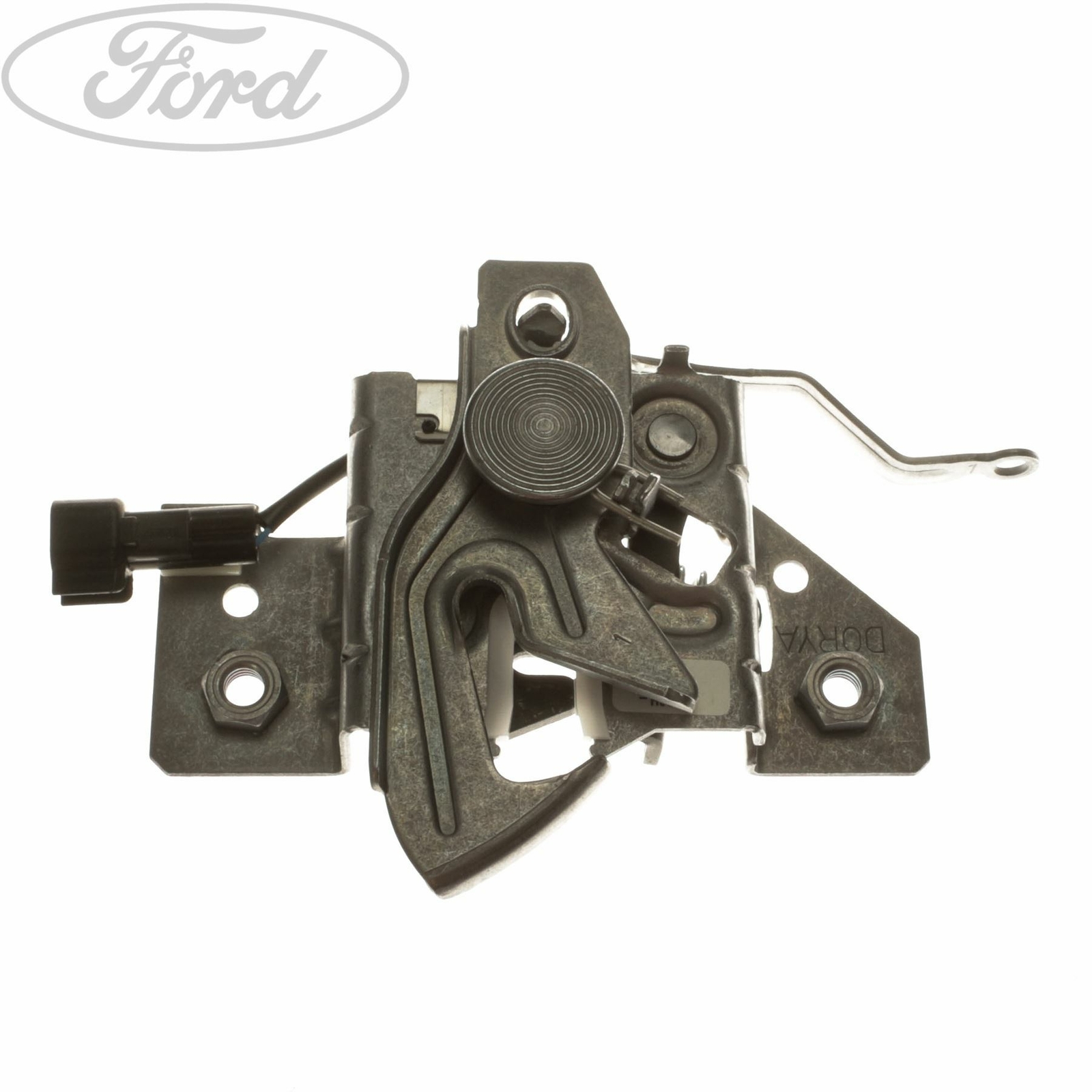

Not all of the Mk6's had an alarm, and as such no bonnet warning sensor.  For the ones with an alarm, the sensor is in the latch, like this.

The OP has replaced the GEM. I'm wondering if his car doesn't have an alarm system, but the replacement unit came from a car that did.
If that's the case he will need to find the output on the replacement GEM and link out the bonnet open connections. Or it maybe possible to simply use FORScan and alter the settings in the GEM to 'No Alarm'
