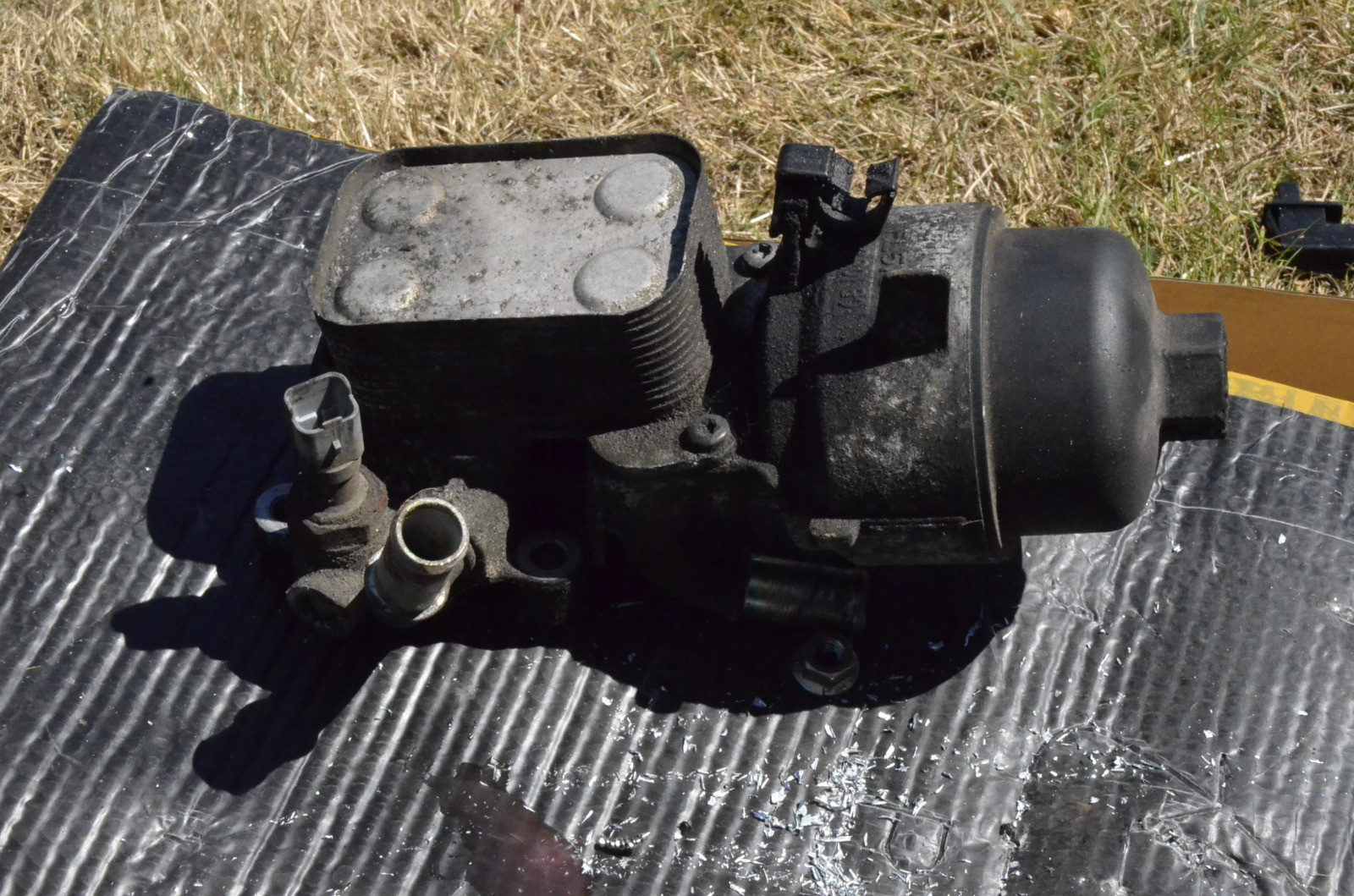

I’ve read a few other people having the same kind of issue. Where changing the oil pressure sensor worked for them but, my issue is, everything I look at is for the mk2 solenoid at the oil filter, videos on YouTube, but my mk1 has the oil filter tucked behind in a awkward place and I can’t see where the switch is to change it as another thing to rule out. Can someone please help with anything further I’m missing or possible cause. Thanks in advance
Oil pressure switch is located at the bottom right hand corner of the oil cooler assembly with a light grey plug.
