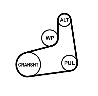

Without wishing to sound patronising, swapping the aux belt is a job that I believe you're more than capable of doing yourself.  Don't necessarily need to pay garage labour.  As above though, it's worth making sure it is the belt causing the noise.  You can even briefly run the engine without the aux belt fitted as a test.  If the noise is still there, you know it's not the belt or any of the pulleys.
This is the belt run for a non-AC 1.25 Mk7.  It's a stretch belt so doesn't have a tensioner fitted.
Image?urlId=wCSvr0CB34avFnm%2F4J8wxjtKy%2F5JztidDtq7EuWePkFBO3cU%2B8RurfzDx7Pt1LY7
Crankshaft - Waterpump - Alternator - Idler Pulley
