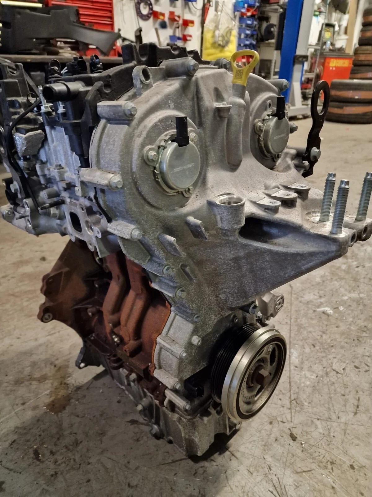

The cam sensors can pass oil themselves.  The VCT actuators are on the end of each cam, outside of the ally camchain cover on the chain driven 1.0.
Ford Focus Engine 1.0 EcoBoost Petrol 14,671k Miles Code: M0DC 2019-2023 MK4 - Picture 6 of 17

Those aren't cam sensors.  They're VCT actuator solenoids.  (VCT = Variable Camshaft Timing).
There is oil acting directly on them all the time.  They control how much oil goes through to the cam variator using an electro-magnet.  The more high pressure oil that's allowed into the cam variator, the further the camshaft timing is advanced.
There are oil tight seals inside the the actuators to prevent the oil crossing over and reaching the electrical side, but they don't seem to be very effective on modern Fords.  The actuators are different on 1.0 and 2.0 EcoBoost yet both suffer with the same oil leakage problem.
The only fix is to replace the solenoid(s) and the affected sections of the wiring loom.
