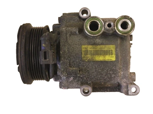

The low pressure, from the firewall connection to the compressor. Ive just had a look. The compressor end of the pipe is accesible without removal of anything. Can get a ratchet up the gap and undo that end. Thats all i was worried about.
Just seen its a dual pipe into a single block job. Im assuming its just a push fit into the compressor coz i cant see any bolts holding it in. £165 from the ford online shop https://shop.ford.co.uk/products/ford-fiesta-air-con-system-tube-hose-2008-2012.
MAHLE ORIGINAL AP 116 000P that might fit but better safe than sorry.
High pressure pipes aren't usually a push fit.  I suspect there's a stud & nut on the compressor that goes through the gap in the middle of that block.
GENUINE FORD FIESTA MK7 1.2 / 1.4 / 1.6 PETROL AIR CON COMPRESSOR PUMP 2008-2012 - Picture 1 of 1
I will inspect further but i dont see a bolt hole in the block.
Cant see on the car either but will have a feel.
