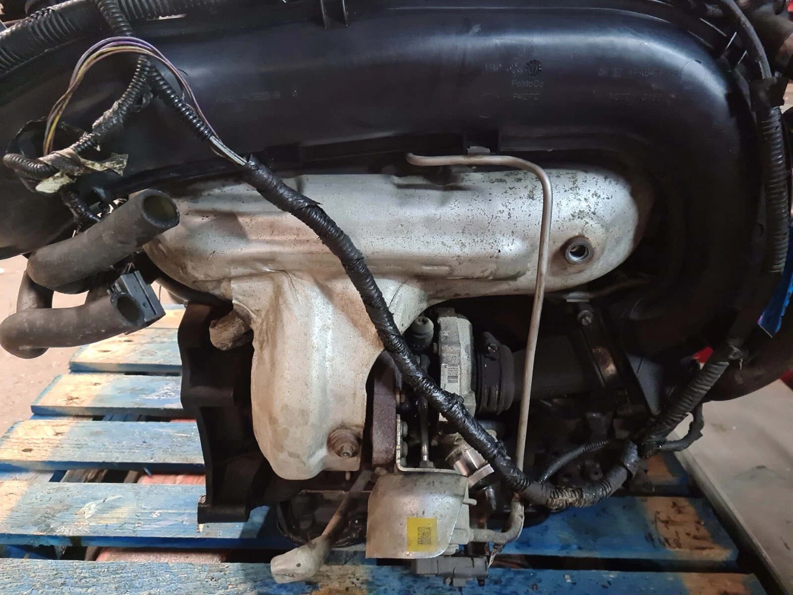

Either way, it doesn't have a wastegate, it's a VNT turbo.  The VNT actuator is a small metal can just below the turbo.
FORD CMAX C-MAX FOCUS GALAXY 2.0 TDCI UFDB COMPLETE ENGINE 2010-2014 - Picture 6 of 7

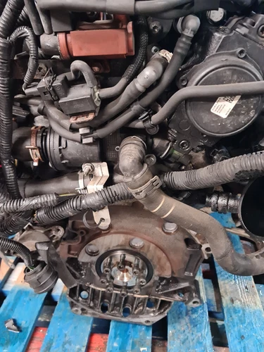

That hard metal pipe going straight up will connect to a vacuum solenoid via a rubber vac pipe, which is likely to be on the right of the engine, near the battery, as you say.  Possibly the brown one at the top here, though it's not a great picture, and may not even be the correct engine.
FORD CMAX C-MAX FOCUS GALAXY 2.0 TDCI UFDB COMPLETE ENGINE 2010-2014 - Picture 5 of 7
