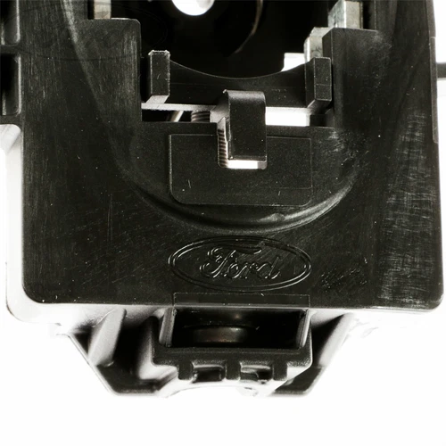

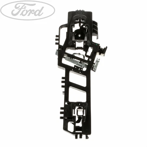

The screw isn't available as an individual part.  It comes as part of the handle mount assembly.

Yeah, I just realised it's still in there but for some reason the part keeps moving about. When I put it in place the screw won't turn now! Do you know if the screw goes inside the plastic part or in front of it?
Ok I've done some research and it appears my screw has removed itself from it's gap. This picture here from another user shows it:
I might have to remove the door card to get to it as wriggling it around to get into place is impossible. The door handle plastic seems to be a bit broken too, do you know if it needs to be replaced?

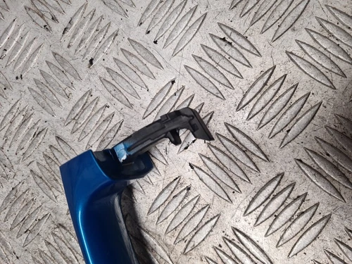

Yes that handle is very broken.  Missing the other half of the clip.
