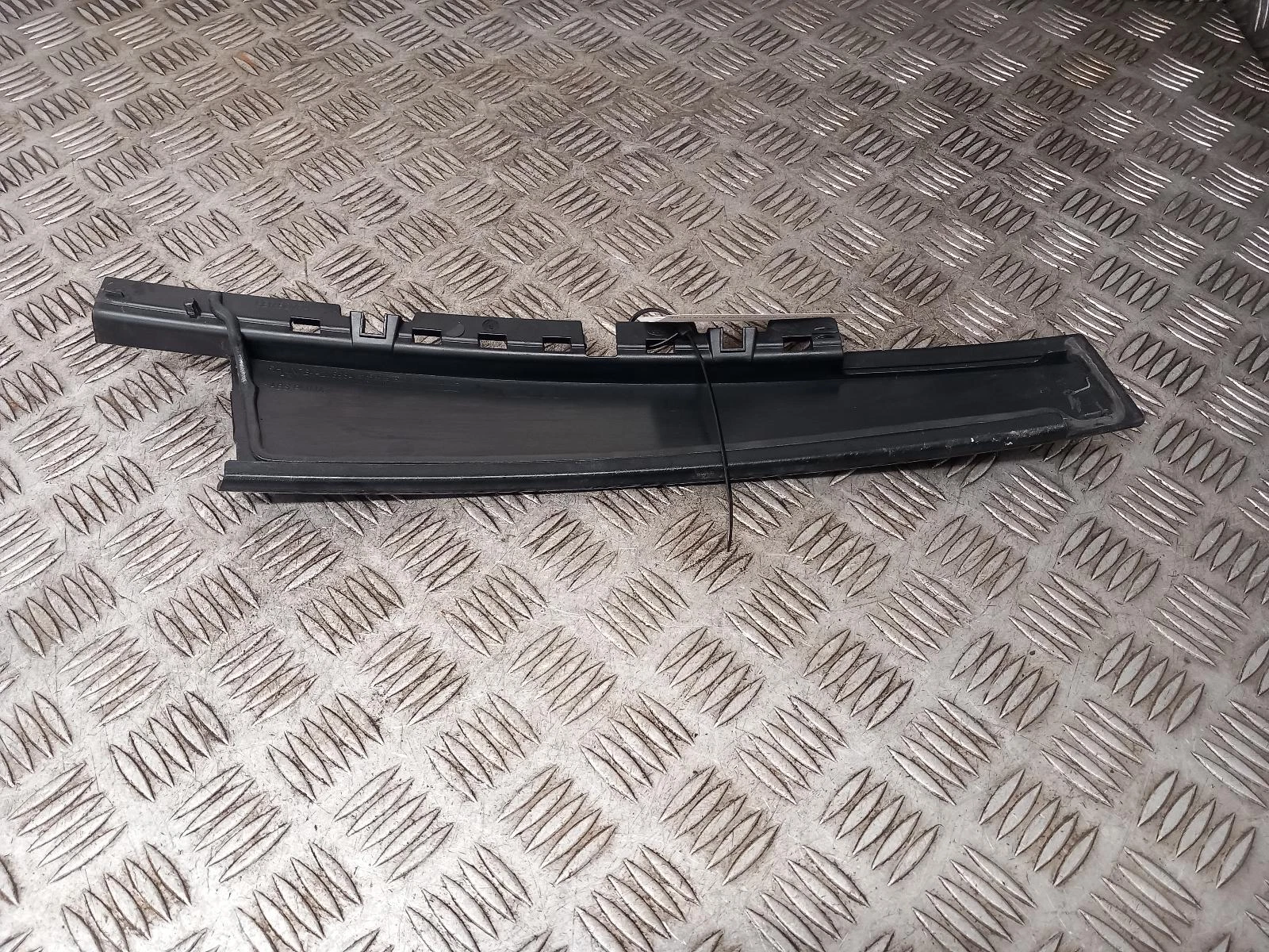

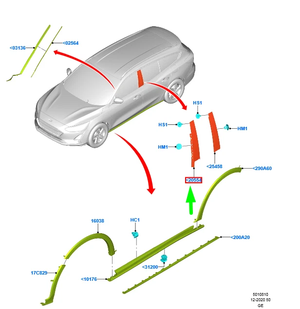

Best I can offer is a diagram, showing an apparent screw from behind the trim.  And an ebay ad showing what the reverse looks like.
FORD FOCUS MK4 Front Left Door B-Pillar Trim 2363957 NEW GENUINE - Picture 1 of 2
Ford Focus Mk4 Right Front Door B Pillar Cover Trim JX7BA20898A 2019 20 21 22 | eBay
Ford Focus Mk4 Right Front Door B Pillar Cover Trim JX7BA20898A 2019 20 21 22 - Picture 7 of 12
I suspect the lower window scraper needs to be carefully lifted out using a trim tool.  The window needs to be lowered all the way down.  Then the screw needs to be removed from inside the trim.  And finally twist the trim away from the pillar to break the sealant line.  Take your time and I'm sure you'll work it out as you go.
