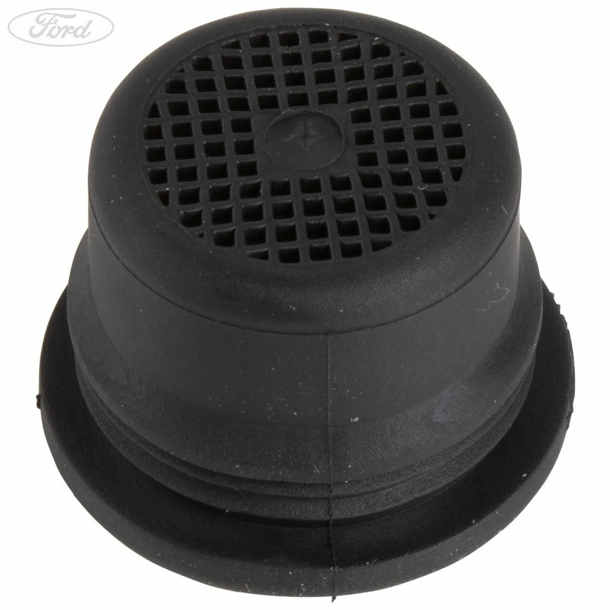

Not sure what the difference would be between a filter and a screen but there is one over the pump inlet on these.  You will need to remove the pump to check or clean it.  In this case, I think I'd have a spare pump ready to fit, in case it does turn out to be the pump.
Genuine Ford Mondeo Mk4 Galaxy S-Max Kuga Windscreen Washer Grommet 1116776 - Picture 1 of 6
Usually cheap screen wash turns to jelly blocking the screen/filter, clear it out and use the recommended with the correct dilute to water ratio.
