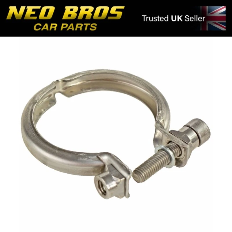

The pipe clamp just uses a normal bolt as far as I remember.
EGR Valve to Pipe Metal Clamp Saab Vauxhall Volvo Citroen Peugeot Ford Mini - Picture 1 of 1
