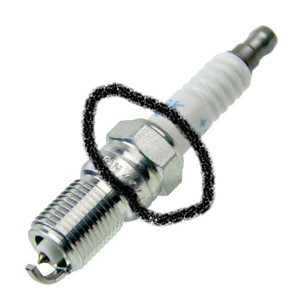

i knew i should have took a picture, my explaination can be poor at times 😞
the oil is on the middle of the spark plug meaning its not on the tip and not on the thread, its where i have circled on the picture above.

Having had the same with the 2006 Focus I had, I would replace the cover seal.
Certainly sounds like the rocker cover seal has gone, leaking oil into your spark plug chambers. The rubber seal compresses soo much that it becomes flush with the rocker cover sill, allowing oil to escape. Seems a pretty simple fix, but you do need to be careful when removing the injectors.

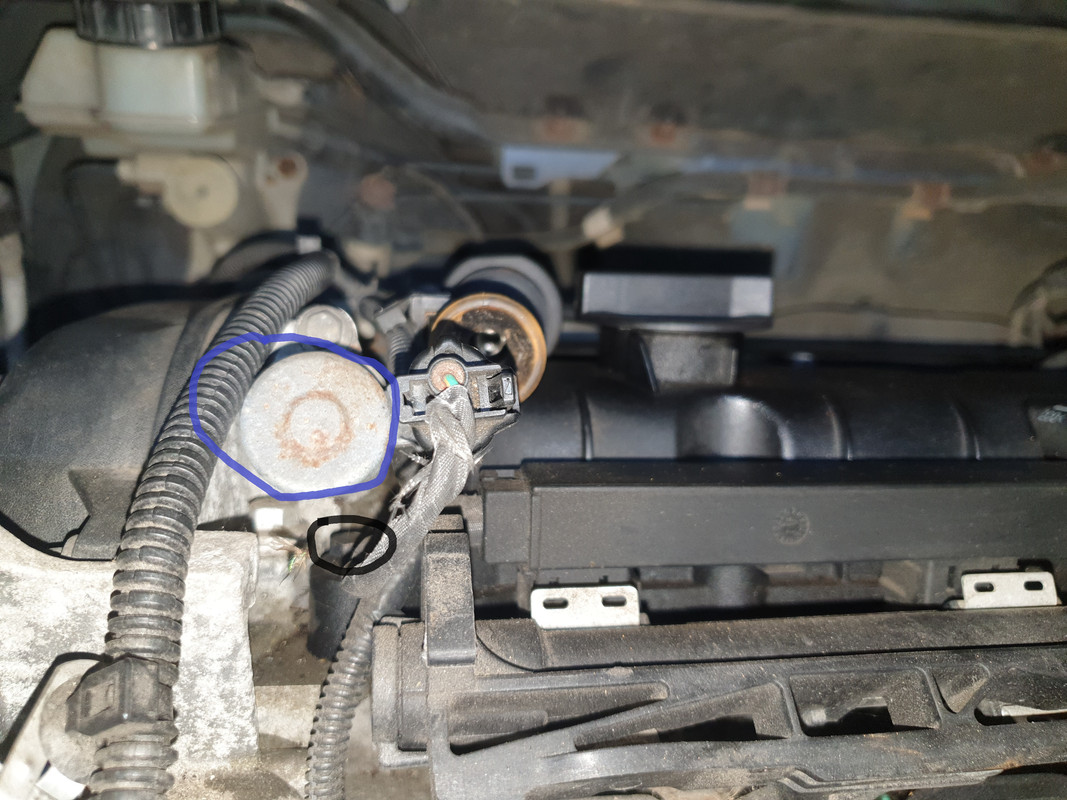

the videos ive been wathcing is very similar to my engine but if you look at the picture in blue circle, that thing is in the way of the bolt in black circle.
anyone know how i can take that thing off as i would need to get to the bolt using a torque wrench?
That's the VCT solenoid.  It's held in by one single bolt right above it.
oh when i had a look at it, it seemed like when i take the bolt off, it would still be in place.
cheers tom, i will give it a go in morning.

It will still be in place, just have to pull it towards you once the bolt is out.

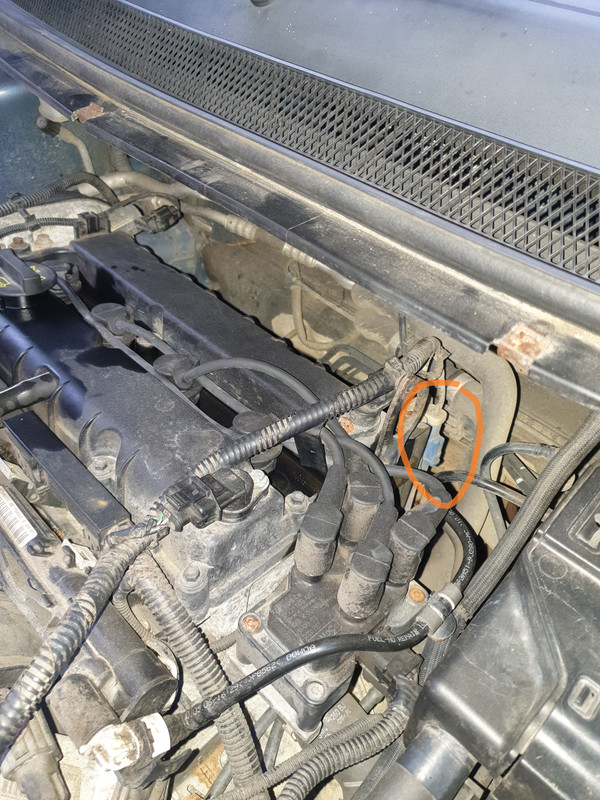

i have managed to take off all the bolts apart from the one i have circled on the picture, i cannot take the metal barcket off. can any help please?
i just did a bodge job, i cut the side of the bracket with a dremmel so i can pull it out from the side and managed to take the cover off with alot of force, it was stuck as hell!!
