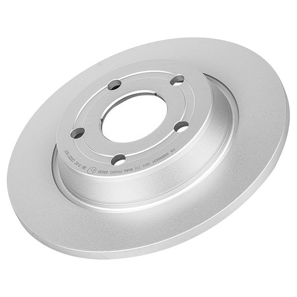

They're £38 on ECP and £24 on Halfords. The latter have been doing some great prices recently. I bought some Pagid pads from there last week for a good price but I'm returning them as I think ATE Ceramic pads will be better. Happy to be told it doesn't matter but my wheels do get brake dusty quickly with whichever pads are on there at the moment.
This is the disc, looks like it's coated.

is there any good reason ATE discs are almost twice the price of the Brembos?
I have read that there are such things as fake Brembo discs (mainly on ebay I guess) and that ECP's Brembos aren't up to the standard of what they used to be. Is that right?
