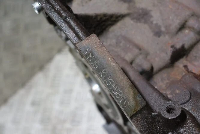

Also i have a photos of what might be the engine number and where i found it. Could anyone confirm if it is the number i need20250904_100430.thumb.jpg.ee78c042a4d3c697388dd7a17943d520.jpg?

These use a cast iron block so you'll probably need to remove a bit of rust to read the engine number.  It's on a perfectly flat section at the gearbox end of the engine block.

The official new Ford replacement engines come without an engine serial number. The official remanufactured Ford replacement engines come with a stamped "XXREMXX" marking on top of the original serial number of the particular engine to render it unreadable.
In both cases the original serial number (last 5 digits of the VIN number) must be manually stamped into the new engine. To identify that the engine has been replaced an X suffix is stamped into the engine followed by a number that indicates how many times it has been replaced (X1 for the 1st time, X2 for the 2nd time, etc.).
In case of a used replacement engine, you can basically do 2 things:
1: Keep the serial number of the replacement engine and go through the hassle to have the "new"' serial number listed in the vehicle's paperwork.
2: Make the serial number of the replacement engine unreadable by stamping "XXXXXXX" markings on top of the serial number and stamp the original serial number of the vehicle into the replacement engine followed by the suffix system that Ford uses.
Personally, I prefer to use method 2. This way the engine serial number is still a match with the VIN number of the vehicle and the suffix clearly indicates that the engine has been replaced at some point. Since the engine serial number remains the same there is no need to change any of the vehicle's paperwork.
