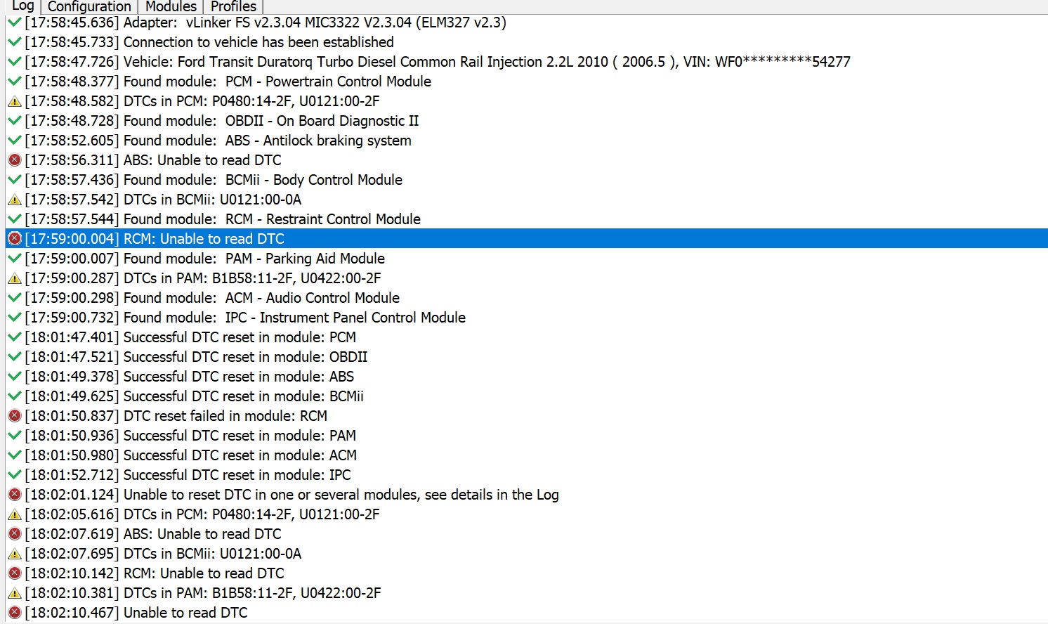

Forescan has thrown up a number of errors. Pic attached.

You've got a lot of "U" codes.
Don't keep trying to reset, research what they mean, it should pin point you to the issue.
Could be just a broken wire somewhere.
The OP is still using the old ELM327 lead which is no longer fully supported by the current versions of FORScan.
This probably explains the 'unable to read' certain modules, and some of the 'U' codes.
Need to change to the vLinker FS cable before digging any further in to the problems.

Thanks for your thoughts. It turned out to be a blown fuse in the battery bay.
The ELM327 I used originally was a vLinker FS and was fully functional. Everything working fine now the fuse has been replaced.
