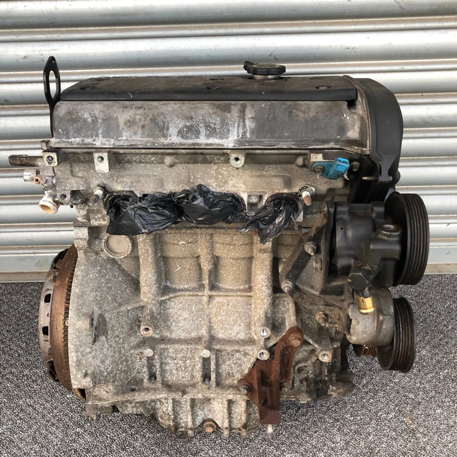

Ok, it looks like there's only one block plug on these.  It's around the back of the engine but I think you should be able to replace it without removing anything.  35mm diameter.
Part number: 1663849
Genuine Ford Plug - Cylinder Block Drain | 1663849 | eBay UK
FORD FIESTA MK6 02-05 1.4 PETROL ZETEC-S ENGINE BLOCK BARE UNIT - Picture 5 of 6
