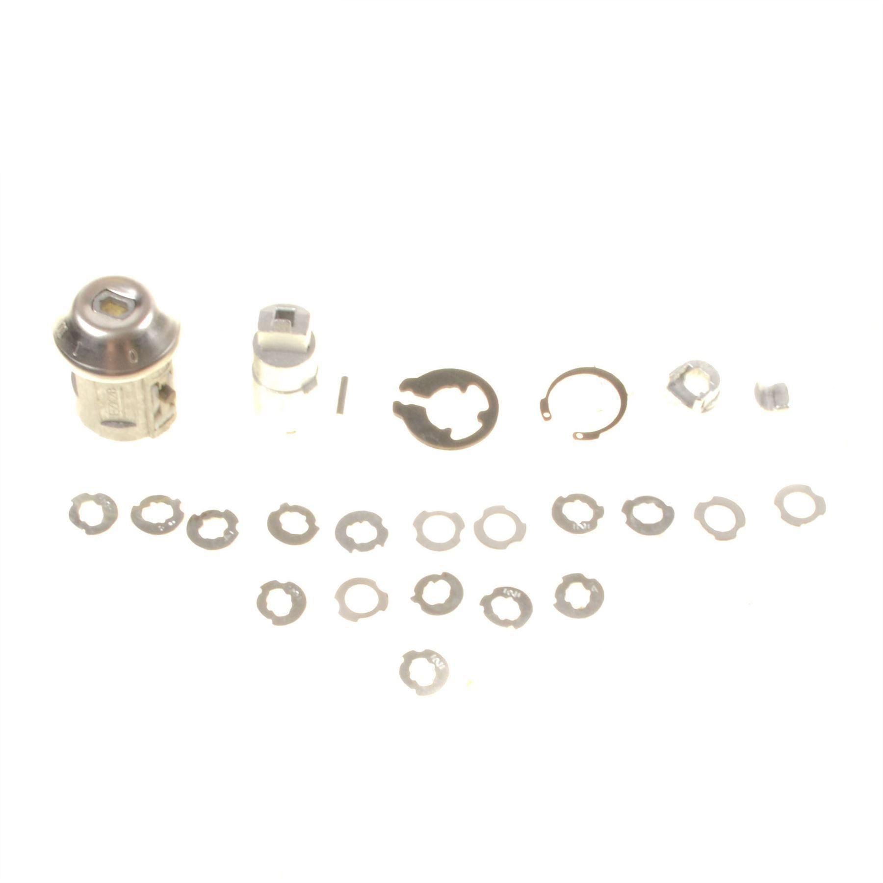

The Tibbe key design is arguably one of the worst key designs. It was used by Ford Motor Company in Europe from the late 1980s to the early 2000s on most models. After that period, the Tibbe design was phased out and replaced by the Sidewinder key design on all newly developed Ford models. The Sidewinder design is still used today on most Ford models and is much more resistant to wear.
I am actually surprised that a 2007 Transit Connect still used the Tibbe design, while the passenger cars it shares many parts with—like the Focus Mk2 and C-Max Mk1—already used the Sidewinder key for Years at that time.
The Tibbe key is infamous for excessive wear of both the key blades and the internal lock plates. Over time, both the key and lock plates develop the same wear pattern, eventually making the key unable to operate the lock.
When a Tibbe key can no longer operate the lock, the only reliable solution is to replace both the key blades and the worn locks. Simply replacing the key blade alone is rarely successful. Common problems include:
  • The new key blade cannot operate the lock because the original key code no longer matches the worn lock plates.
  • The new key blade operates the lock but wears out quickly due to the excessively worn lock plates.
  • The new key blade works initially but accelerates wear on the lock plates, eventually causing the lock to fail again.
There is, however, a small chance that a new key may work for a few months or even years, so it’s always worth trying.
Since Tibbe keys are now obsolete and require specific key-cutting tools, fewer locksmiths are able to cut them, which partly explains their high cost. Many people now order pre-cut keys from China for less than €10. The key code can be visually identified from either the original key or the lock plates.

STEERING COLUMN IGNITION LOCK REPAIR KIT 1976-2013
---COMPATIBLE-INFO--- ---DESCRIPTION--- This product carries a £0 surcharge. This is a refundable deposit, repaid to you when we receive your surcharge product back. We will happily refund your surcha

It is possible to build the barrel up yourself without any special tools. You just need to work out the code from your key, or split open the old barrel to work out the code from there instead.
Each of those plates is coded with a number from 1-6. The kit comes with more plates than you need, and obviously you have to put them in the correct order otherwise the key won't work.
It is fiddly to do, but I've done it myself in the past so not impossible.

If you were given the code with the key that was cut, or can work it out from looking at the fresh cut key, then you can build the new barrel before removing the old one.
It only took about 10 minutes to remove the barrel. There are plenty of YouTube videos showing the process. Just have to remove the plastic cowl behind the wheel. Then press a little tab in on the barrel while pulling with the key at position 2.
I needed to strip my barrel to work out the code to get a new key cut. Seem to remember it took around an hour to strip down the barrel and then rebuild it again. But I was taking care to do it all carefully, lay out each piece in order, and then the same in reverse.
Overall it really should be done within a few hours maximum.
