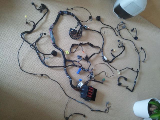

For this project i bought a Titanium under dash wiring loom
So now i need find it out how the wires goes from the cruise control, and of course for the electric folding mirrors :D
Just need some days :(

I checked the cruse control wiring... I have not a cruse control on my car, but the wiring is there until the air bag rotary thing
i bought the silver wheel cover with the cruse control switch and the wire to the rotary thing...
After every thing connected and back to the place, nothing happened, when i turn the lights on the cruse control switch light up as the radio control, but not working :(
i asked the Ford to add the cruise control to my car, but they said: unfortunately not possible. The control computer (ECU is one) can be programmed once and can not be overwritten.
I hope they was wrong, i do not think it is true...
I`ll not give up! i need it
