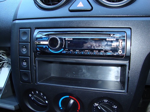

I cut the bars from mines and got a bit from Halfords and fitted my Sony din sized stereo, i can upload a pic of it fitted if you want.
My "Flame" is the same so I would be interested in seeing some photos. Also what size are the speakers in the front doors and (in my 3 door) the rear side panels?
where the bars got cut is still a bit rough, haven't had time to sand it down yet.
Looks good though and the sound is far better than the original.
