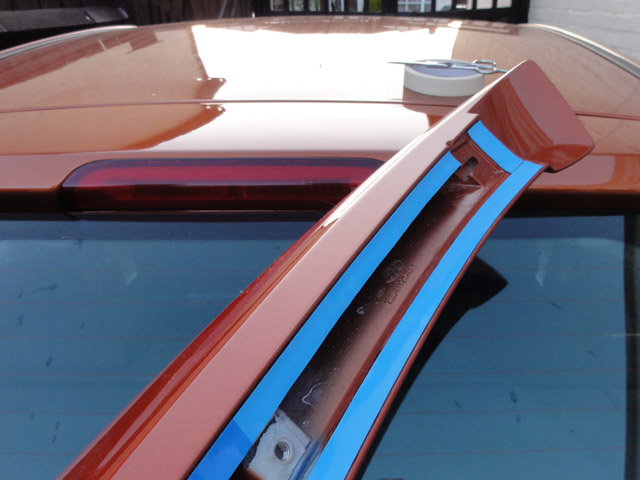

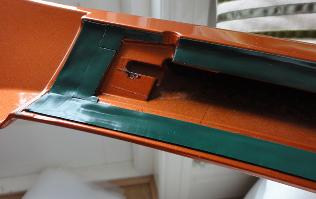

It's now bolted and stuck with double sided adhesive foam - here's how did it:
Re-taping
Because I'd used the previous tape (blue in top picture) I had to pick it off and start again. I spent some time shopping for the right tape, but considering I'm using bolts I'm not too worried about its adhesive strength.
I found this 12mm wide x 1mm thick "automotive double sided foam tape" on eBay for less than £5. I emailed the seller and they confirmed that this tape is suitable.

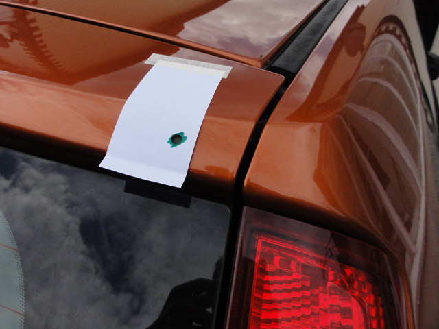

Marking The Hole
There're a few ways of marking the holes, but I found this way easy enough. I'll try to explain. The paper was stuck to the spoiler before being stuck to the car.
Cut two bits of paper, roughly the same size. Use a hole punch for the holes. Put a strip of masking tape on one side of paper. Line the paper hole up with where the bolt sticks out on the spoiler. Then stick the tape down to the bottom of the spoiler.
Place the spoiler on the car with the paper in between. Position the spoiler where it seems to fit snug to the car, use the boot break light to centre it to the car. Get help with sticking the exposed paper to the car. Once stuck, get help unpicking the tape from the spoiler. Now remove the spoiler and use a pen to mark the holes.
It's slightly nerve-racking that you've got to get these holes right first time, so I double checked the position of my markings by measuring the distance from the hole to the edge of the boot frame, top and sides.

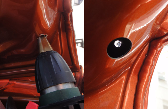

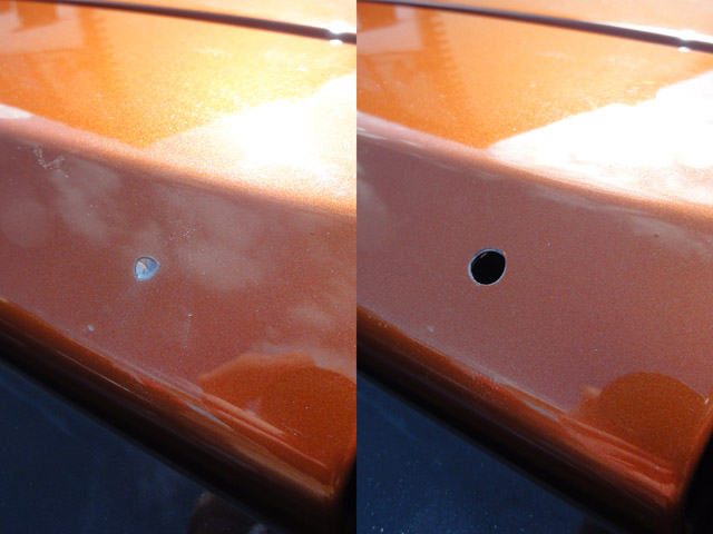

Hole Making
I started the hole by tapping a nail to help prevent the drill slipping. Then used a smaller bit before going all the way through with a 6mm bit. I've read that you can damage the surrounding paint if it gets too hot, but I kept the drill on the slowest speed and didn't see a problem.
The larger Inner Hole
I found this part the trickiest, trying to line up and mark a hole on curved metal. Using a strong long nail, place it through the top hole and hammer it hard enough to make a dimple on the inside. It's difficult getting the nail to dig on metal at an angle, but if you sharpen the point it will work. I could just post the measurements now I've done it, but not right now.
I used this "taper drill bit" to make the 16mm holes, it's supposed to be easier for drilling metal and reduces friction/heat. I found it easy enough to use, though you either have to mark out 16mm on the metal or keep stopping to measure the hole.

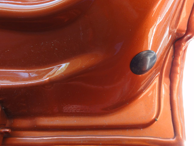

Done
After finishing the holes I painted the bare metal with Hammerite... just in case it rusts! To finish it off I bought these 16mm blanking grommets from the almighty eBay for just over a £1, which makes it look quite tidy.

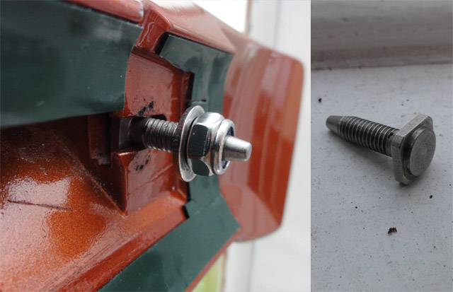

The Bolts
This bolt should be with every factory fitted spoiler (not sure about the ST spoilers), the problem I've found is that don't have a nut attached. I came across a great company (westfieldfasteners.co.uk) where you can buy nuts/washer in any quantity and not have to spend a small fortune on multi-packs. This 6mm (M6) bolt is obviously unique, so not any old bolt will work.

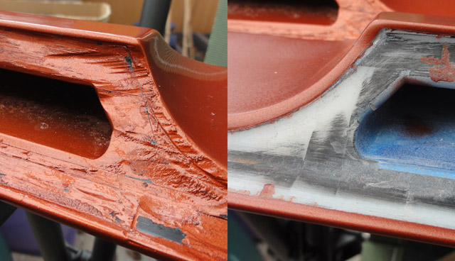

Before bolting this spoiler I did try just using the foam tape (read older posts), but had problems getting it to stick, and this is why:
The spoiler was second hand with foam still attached and the body shop said they had the tools to get the stuff off. I don't know what these tools were but they made an absolute mess of the plastic surface (left). The right picture is my attempt at spraying (another spoiler), as you can see I removed the foam with a smooth surface, without special tools.
This is why the spoiler wouldn't stick well, because the spoiler and foam surface was so uneven it wasn't making full contact. Some groves are so deep that the foam doesn't touch the car.
