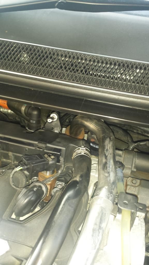

not sure if any of these are any good????
Any ideas
Can't work it out from pics sorry mate, follow the intercooler pipe to turbo and it should be near there
No idea where too look.
The EGR is attached directly to the Inlet Manifold.
It's under here i believe.
This is what you're looking for-
Look for this unit as this is the EGR cooler and is attached to the EGR where the blue ring is.

I have a 2007 2.0 tdci and the egr is at the back of the engine near the top on the right hand side in Front of the bulk head, you can trace the metal pipe from the inlet manifold at the front.
disconect live from battery and protect.
Locate and remove egr coolant pipe from egr cooler a small Spring clip for easier access  you may lose a tiny bit of coolant
Remove clip mount in middle of long pipe  mounted on top of the engine
Removing appears to be easy  unscrew torques from pipe that goes into the inlet manifold then  undo 2 bolts 10 mm socket required which secure long pipe.
Remove 2 more bolts on the back top of egr valve 8 mm.
then undo 2 10 mm bolts that secure it to the egr cooler
 Then this is where the problem started for me  I find there was a Allen key bolt underneath the egr valve  which is mega awkward to get to  in the end I gave up
