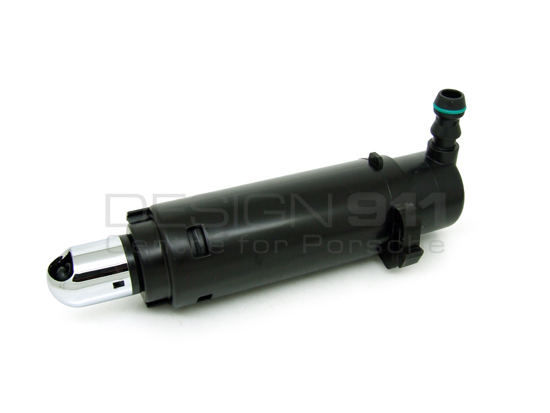

i find some Nozzles, but i don't know the diameter and if they fit.
Both Nozzle are from a Porsche

My problem is, to find the right nozzle.. Because the Front is very steep.
