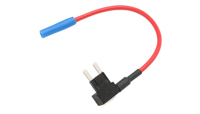

If you already have a socket, with a fuse in it, and you simply want to "steal" power from that, maybe this would be a solution?
Don't know the English name for it tough!

I used one similar to this:
Clip goes on ground somewhere (find a pice of frame or something)
