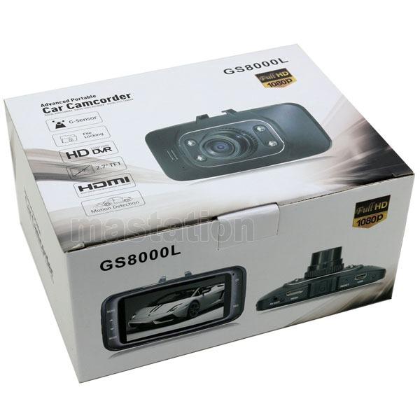

ALSO.. not much of a big deal, but the ebay pictures showed a nice 'company made' box the usual thing:
http://s3.amazonaws.com/thmb.inkfrog.com/pix/goods4you/VD-GS8000-13.jpg/600/0
Something like that.. When it arrived it was in a jiffy bag with a tiny black cardboard ripped box with a handwritten label on it.. so all in all I didn't get the good experience from the seller that I'd have liked..
