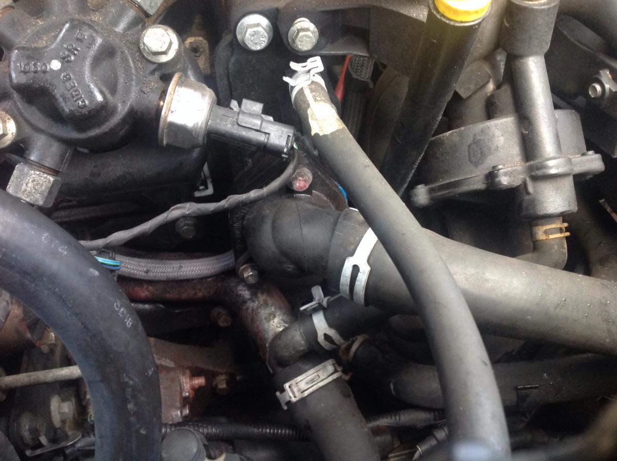

I found the leak!
I'm 99% sure this is the Thermostat housing now.

the thermostat housing is the housing right in the middle of this picture: its from the MK2 but it should look similar.
Yep that's your leak if I remember correctly only too.s rqd are a ten mil socket and a pipe wrench to get the clips off the hoses shouldn't take longer than half. Hour
