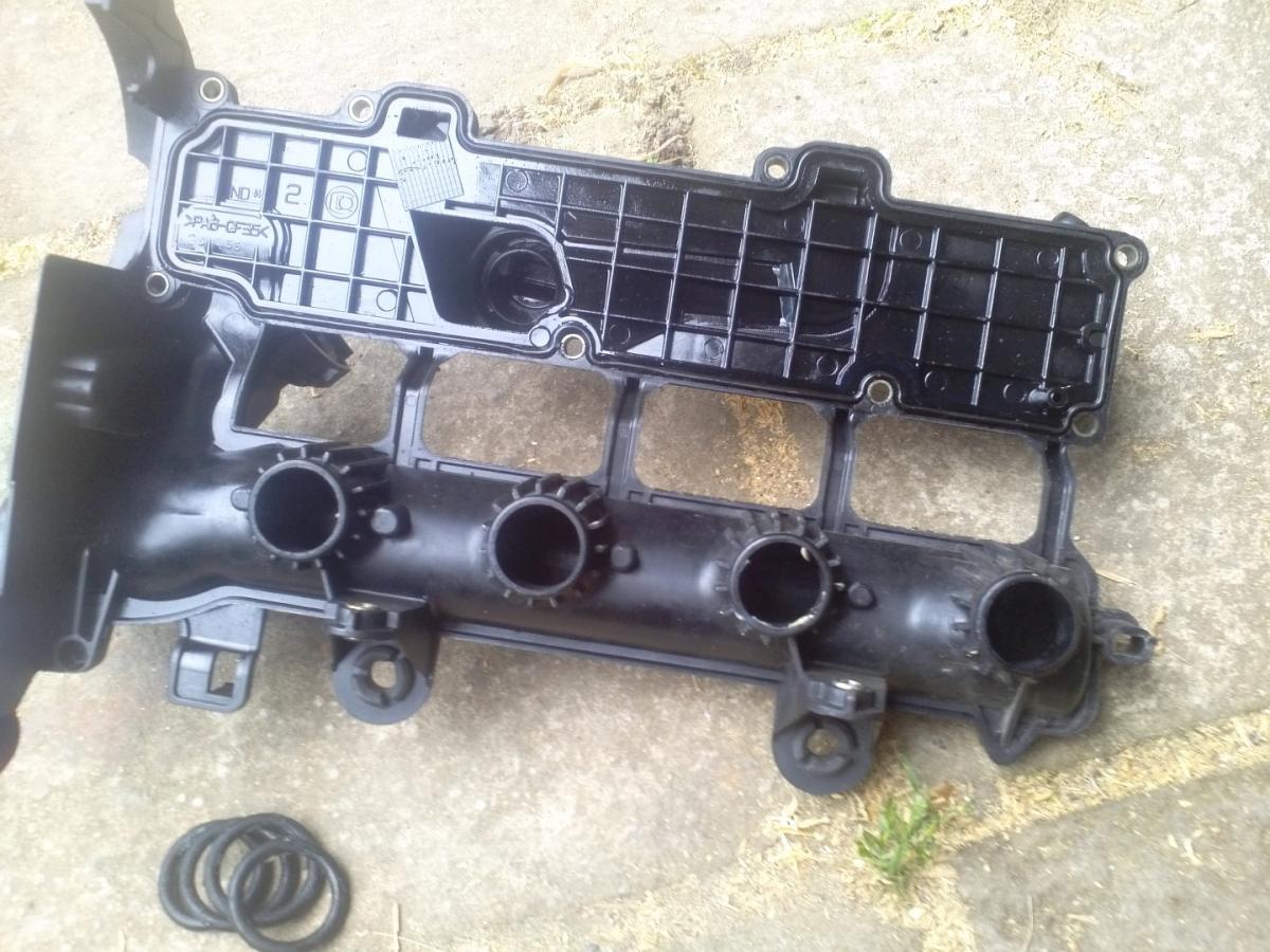

I couldn't quite get onto the bolt using the adaptor, but could still get a spanner end on onto the bolt, the things that were getting in the way were some thin plastic stringers going across the manifold, below is a photo of the manifold taking from Gombal's thread (found on Google image)
I can see that each side of the inlet manifold/breather setup is held in place with either the 8 bolts on one side, or the manifold itself plus 2 additional bolts on the other - my question is, could I simply remove some of the middle supports from the inlet manifold to give me access to the injector bolts or would this cause an issue?
It would alter the rigidity of the manifold, the inlet side of manifold is relying on the cam cover bolts to keep pressure on the seals. Just take it off and do it properly as from what I remember you had the seals and washers to do it?

I do indeed, was just wondering if there was a way to check the injectors were torqued down correctly without needing to remove the whole inlet manifold - will just put a few days aside to do the work, to be fair most of the parts such as the airbox are already off the car - its the bolts down the side of the engine that I am most worried about due to limited space.
If you have the stuff , it doesnt take long to do, time consumer is cleaning the bores for the injector washers. And not let any hard carbon debis go down hole in to combustion chamber
