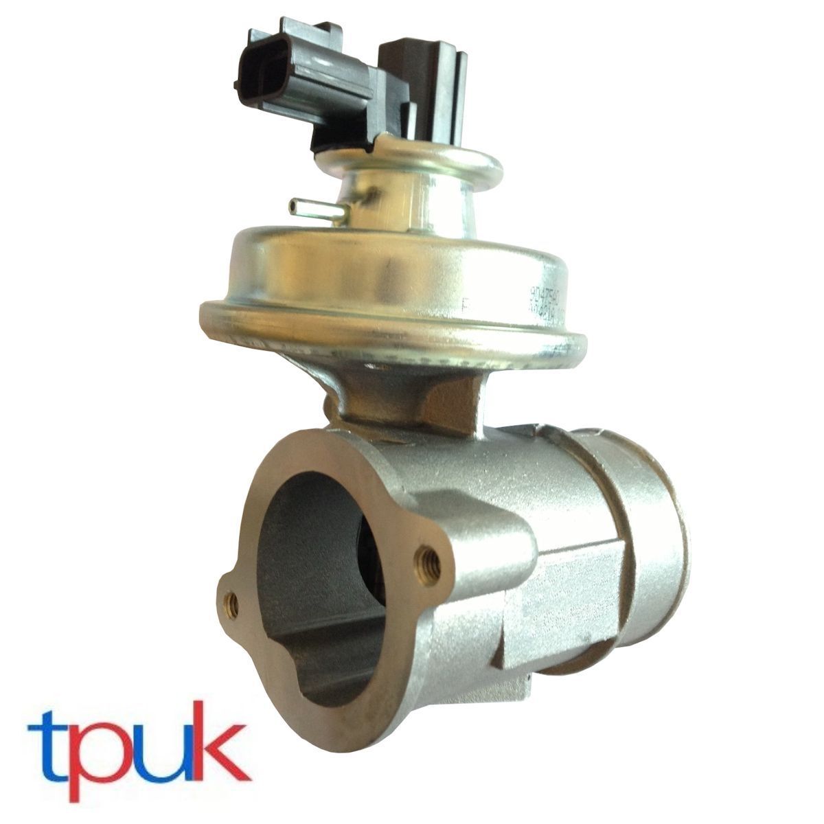

And does the egr valve look like below? If so, it looks to be vacuum operated via a little solenoid valve somewhere, and the 3 pin connector is probably a position feedback sensor.
http://www.fordownersclub.com/forums/applications/core/interface/file/attachment.php?id=41003

And another type of EGR (electronic) is shown here, does that match? (I added the missing Vacuum pic to my last post)
It's tge first pic took the valve off and gave it another even better clean then reassembled it in casethere was some dirt stuck in it. my scanner came today plugged it in and sure enough I had 1 error code P0405.  EGR flow sensor A circuit low input. Clear it and it stayed off this time. All I can think is I didn't clean it well enough the first time or the loose  jubilee clips etc the sensor off as the car has never run as well as it dose now. And no code showing after a 15 mile drive. So fingers crossed.
