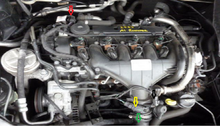

Hi
My car did this several times, I found the route cause to be the butterfly within the inlet manifold. It was all gunked up with an oily substance which was restricting it from opening upon start-up. I removed the hose clip shown beside the green arrow in the image and then pulled the hose toward the front of the car toward myself. It takes a bit of wiggling, but once off you should be able to feel the butterfly just inside the inlet manifold where the yellow arrow is. Clean around this as best you can and then put it all back together again and see if this sorts you out. I've had to do it twice in the last three years.
Regards

On 12/31/2017 at 2:07 AM, juniorferg said:
Hi
Regards
This may well be the lumpy starting, but will not cause the failing to even turn over
