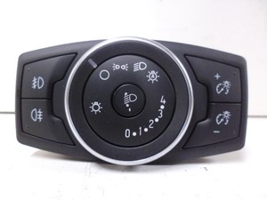

I've just been doing a bit of digging on google.  I don't have an 'auto' position on my headlight switch, just 'Off', 'Sidelights' and 'dipped beam'. This is what mine looks like..
Can you see if your mate with the zetec S has an 'auto' position on his switch.  Like this...
If he does have the auto position, this might not be as straight forwards as we're hoping...
my zetec has the auto light section but because it doesn't have the sensor on the windscreen all this does is leave the lights on all the time (and has them as coming home lights when parking up) auto switching them off after about 30seconds
Good, so thats not tied in with having DRL's then.
Mine does that if i just leave the switch in the dipped beam position, however, if i leave the switch in the sidelights position they don't switch off  :huh:
That's normal as what we call side lights are actually "parking lamps" and thus if you switch to these only the car will think you're using them for this reason.
