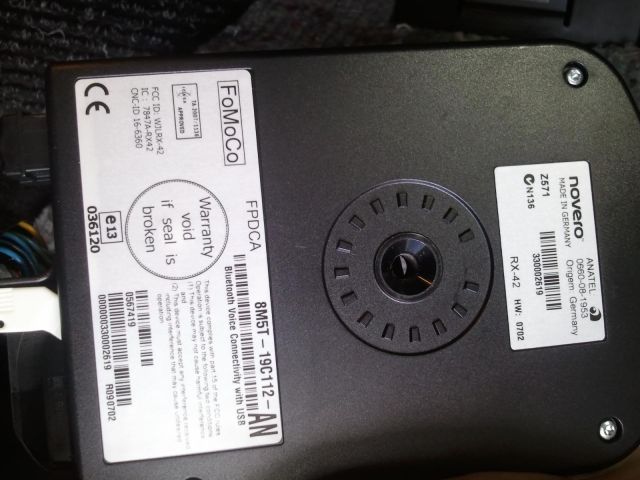

This is my module with USB (ending AN english ver.)
but if i have a Focus i go with This come out cheaper end of the day...
