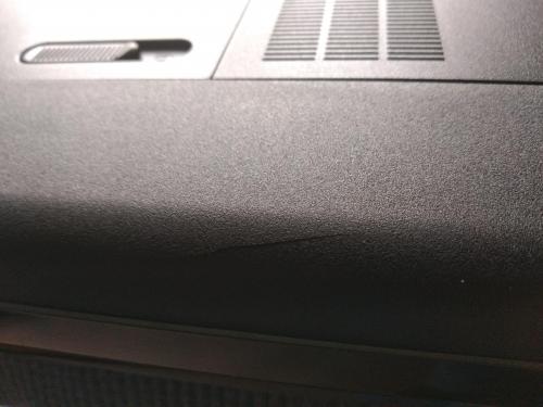

I've found a crack in the battery casing today.  Don't think it was there originally but I was more focussed on the other side when I received it.  Should I be concerned about it or is it just cosmetic?

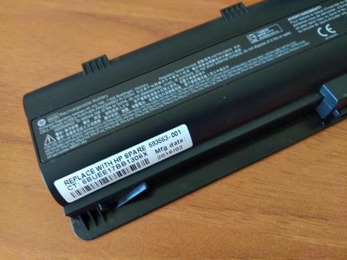

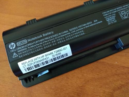

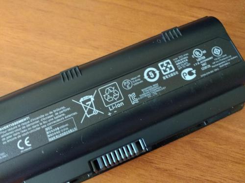

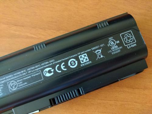

Here are a couple if pics of old vs new, can you see anything there to confirm that the new one is a fake?
Old (genuine HP)
New (sold as genuine, believed to be fake)
If it's on the battery itself then it isn't worth the risk. We all know about Li-On batteries exploding with just the slightest of knocks (it sets off a chain reaction in the inner cells).

Maybe it is a genuine, but used battery - maybe from a job lot of faulty notebooks?
