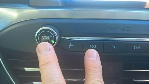

I had this park assist problem on my 2019 Focus Titanium three days after I collected from the dealer in November 2018. I had so many failures that the dealer gave me the way to reset the system without having to visit the dealer.
To reset the system you access Bezel diagnostic mode by holding the on/off button and skip back simultaneously for five seconds on the central audio controls on the dash. (see the photo attached) Once in this mode you just need to exit the diagnostic mode and the park assist is working again.
I had to reset every week or sometimes twice a week for nearly eight months until my vehicle got all the vehicle updates that the dealer applied in early June. The park assist has not failed for sixty days, thank god.
Do you get any screen instructions, beeps or other indications that it is in diagnostic mode? What else does diagnostic mode do?
Sorry for the delay in replying, there are loads of tests in here
When you access the test mode it tests the speakers first then you you press the on screen back arrow (top left) and a list of tests appears.
I have only selected exit at the bottom of the list to reset the active park assist.
