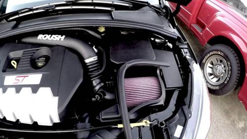

Steeda
or Roush
Quick video on YouTube with the open RS lid.
Usually there are quite a few used ST boxes and pipes on eBay but I guess it's becoming a popular modification now so no complete units on there at the minute.

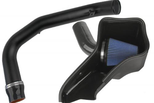

Found these two on eBay but they are a little pricey.. gonna keep an eye out for a second hand one.. note to my friendly breakers!
Quote
Don't forget though if you're looking at the complete ST/RS box rather than just the lid you will need the additional piping for the extra cold air feed too or you will be left with a big hole in the bottom of the box.
I quite liked the idea of the Steeda one that I pictured above, it looks like it feeds directly from the grille.
Otherwise yes, I understand that I would need to pipe cold air into it, but thanks for the heads up!

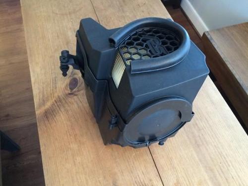

So we're left with the RS air box which I'll probably go with. I got the part numbers and made a couple of pictures. Price wise the complete unit is around £130 whilst the top is around £80 so it's far more cost effective to go with the complete unit which even includes an RS paper air filter! I can justify throwing £130 at this idea.
I'll probably run the paper filter for a year and then upgrade it to a K&N E-9289 filter as mentioned at the top of this thread.
I'm a little concerned about the other pipes that go into the original RS box, my attached diagram doesn't show any piping for the underside so that's obviously not an RS/ST diagram. Is it just the 2nd cold air feed that will be missing, will everything else match up?
If I am missing an underside cold air feed the guys over at Focal Jet may have a rather cost effective solution.. I'd need some additional information relating to the underside of the RS filter box and if the 3" pipe will fit without modification or not, ultimately it's not really a problem but I do try to know as much as I can before I start these projects.
Actually looking a my own pictures of the RS airbox it looks like the second feed is below the filters inlet manifold? If that's the case I guess it could be blocked and I could cut a 3" whole in the bottom for the new ram air feed.

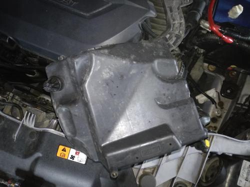

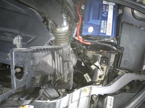

So as I said in my caliper thread, I've been doing bits and bobs on the car today. Whilst I waited for the first coat of caliper paint to dry I set about removing my audio fuse holder and replacing it with my newer one. Obviously to do this I need to remove the battery and what makes that task even easier is to remove the air filter's air box. That in itself is quite handy as I've never removed this before and thinking about changing this unit for an RS one it'll be very informative for me to do.
Airbox removed.
Airbox underside.
What's lurking under the airbox?

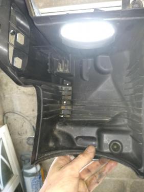

Airbox held up to the light showing three tiny holes.

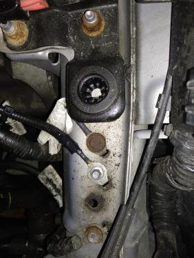

Question :
Am I supposed to have a device (can't remember it's name at the minute) connected to the underside of the air box and screwed up onto the chassis somewhere which minimises the intake sound, like a harmoniser or similar? I couldn't see one.
On 3/9/2019 at 5:59 PM, Ubetcha said:
Question :
Answer :
No, stop reading those American threads and maybe you wont get confused!! American cars have a lot more 'state laws' and fit intake resonators to quieten down the noise, your UK car wouldn't have one of these!!

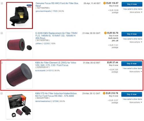

OK, so my next picture is a bit of a LOL, it's the prices for the different models of K&N's suitable for our vehicles, one hell of a difference in price seeing that really they don't improve things.
High lighted the E-2993 as I'll probably go for that one if I keep my closed Zetec airbox. I've been giving this some thought, yes the RS airbox looks fancy but it's not going to do very much in terms of performance so I'm just throwing a fair chunk of money down the drain. Hmm i'm undecided..
Should I decide to go ahead with the RS airbox, and possibly the E-9289 and remove the bung I know I'm going to enjoy the induction noise. Does anybody know the external diameter of the original RS paper air filter?
The E-2993 Outer Diameter is 159mm,
The E-9289 Base Outside Diameter 5.75 in (146 mm) according to this
I'm just wondering what the original RS paper filter outside diameter is so that I'll know if they'll be a gap or not. The more I think about this the more i'm moving away from this idea.
Here's a side view of the RS airbox that you don't see too often, if I kept the E-2993 and upgraded to the RS airbox would the E-2993 seal against the edges of the RS airbox or would I have to then buy the E-9289?
The sides of all the filters must be the same size as they sit in a lip in the bottom section of the airbox and in the lip in the airbox lid to form the right hand side of the airbox. It's just the 9289 has a small removable bung in the centre of it.
If you're going for an RS lid I doubt there will be any difference In induction noise between the 2993 and 9289 because of the large opening in the top of it.
