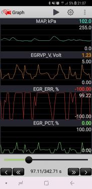

Ok, downloaded forscan for android today and so far it's the best app ever. Alright it's not as good as laptop version, but I don't own a laptop so it's next best thing. Run all sorts of pids and found something interesting. Looking at the picture, the green line is egr position commanded by the ecu. The red line is position v command error %. Looking at both lines could it be fair to say the egr valve is fooked ?? Or can it or the pcm be reset ??
