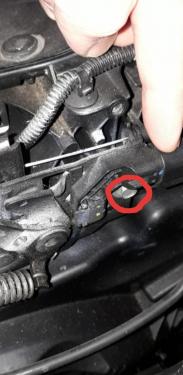

Thank you for posting that. I’ve had another look today. This is what I’ve found. Does it look right to you?
Yours above, mine below.
If you look at the bolt circled red for a reference point then you will see yours has part missing. Has it broken off? The loom connector must be in that area somewhere.

these are the pics I’ve just taken.
Wasnt sure if that plug relates to the bonnet or not.
The latch certainly looks different, nothing is broken, looks factory to me with the imprinted ford logo.
I’d be fairly certain the plug Wes has circled is your bonnet latch switch, just pull it up into shot, there’s a chance it’s been knocked off or broken. It should locate in those key hole type slots on he latch.

It really depends what that plug is plugged into, hopefully it’s just hanging down and when you look next it’ll come up with the little switch bit on the end and all will become clear.
Heres a piccy of my old latch, you can see the two key hole slots on the right where the switch locates, (switch is at work else I’d picture that too). Also the part number off mine, although it looks as though your ends with BF not BG?

Ok you are both legends. Thank you so much. The plug was indeed hanging down, I honestly thought it belonged there.
one last favour, can you confirm from the pictures below if this is broken and missing a cover? Looks like a tab is missing too?
Yes it looks like one of the two little round tabs is broken off. They’re quite weak I think and must get broken off easily if they get knocked.
