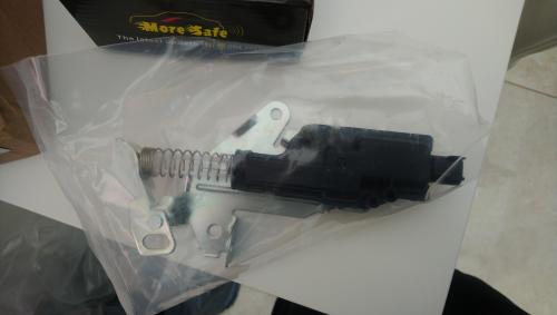

When the boot solenoid arrives I'll show you the date of the motor. Looks exactly the same as the broken one. It's been several days since its said its been dispatched. Want to get all these bits done in one day so just waiting for that.
New one I bought from a breakers. DSC_0091.thumb.JPG.0160c458e6bb46255d419199650880dc.JPG
@TomsFocus just came home and it arrived 😂. Would you say it looks right? Just asking so I don't go through the trouble of opening things up and finding it doesn't fit.
Yeah, it looks right! :biggrin:

So changed the solenoid today and now works 😊. Actually sounds to work a lot better than the time I bought the car. The old ones spring was a lot harder to compress compared to the new one.
New (left) next to old (right)
