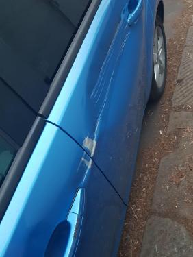

Thank you,whats the difference between the two, do you know? I thinks the colour maybe the same but ts the angle i took my car photo at...this is a close up of my car with the damage as well 😞
there both mk 2.5 face lift models
The scrap car is a facelift model, same as yours.  You will need to swap your privacy glass window into the other door though.

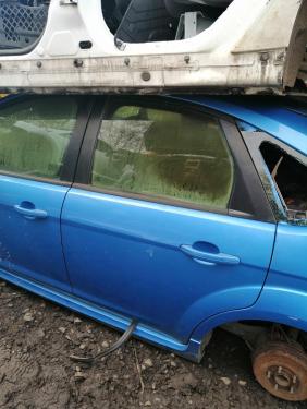

Also it looks like there's a car on top of the scrap one, that may have bent the door!!

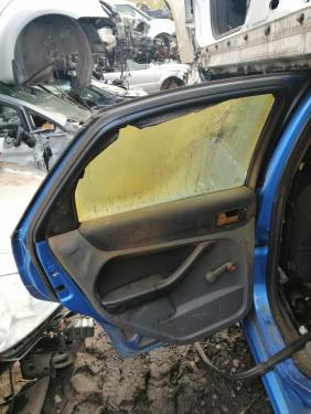

These are the other two images from the scrap yard car. It is a bit of a state and we need all our interior and glass swapping accross, Hoping it is a simply swap for a bodyshop place to do.
Thanks guys.
Thanks guys.
That colour is Vision blue, it was only available on facelift models so it must be a facelift.  Interestingly, there isn't another way to prove if its facelift or not just from the rear door, its mainly the bumpers/lights/boot/bonnet that are different!  Having said that, most pre facelift cars did have rub strips on the doors, whereas the facelift doesn't usually, so that's another good indicator.  The scrap car is a Zetec S trim judging by the sideskirts - does your car have rear electric windows as it'll be a bit of a pain swapping all the internals and loom over to the new one if so.

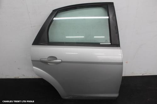

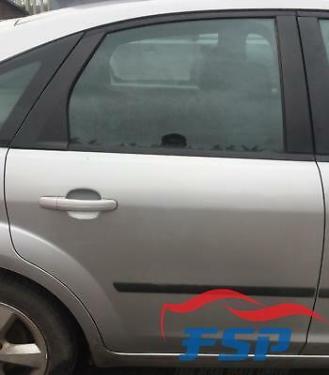

You can tell which version the doors are from as there is a plastic bump strip on the pre-facelift doors which is absent in the Mk2.5.
I agree with previous assessments that the photos of the door you have taken are from a Mk2.5.
Sent from my G8441 using Tapatalk
The actual bodyline of the car is different. The horizontal "crease" going across the door handle has 2 bends in it and is a lot sharper of a bend, where the pre-facelift just has a small curve to it.
I can confirm that as above, as long as you find a door which doesn't have the plastic strip (and not just 'cos it was pinched!) You should be all fine and dandy.
