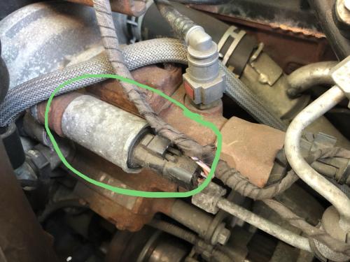

Just to confirm, is this the regulator (in pic)? That's the part the RAC guy pointed to 😉
Appreciate your help!

Yeah, that's it. :smile:
Its not the one I linked above though, looks like it's this one instead - https://www.ebay.co.uk/itm/VDO-Fuel-Pressure-Regulator-for-Ford-Citroen-Peugeot-1-4-HDI-TDCi-X39800300006/264060952821?epid=1616922433&hash=item3d7b4260f5:g:zxQAAOSwe~lb~DHj
Or you could risk this one at half the price...  https://www.ebay.co.uk/itm/Mk4-mondeo-2007-1-8-TDCI-VOLUME-CONTROL-SOLENOID-VALVE-X39-800-300-006Z/223484543970?epid=1616922433&hash=item3408b783e2:g:kJEAAOSwyElckSWY
