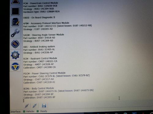

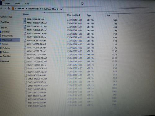

I have some info of forscan but the bcmii numbers don't match completely with what's on focccus ab file
i have these
i have these

22 hours ago, steve.s said:
i have these
The numbers shown in Forscan are not the numbers you need. The most important is the hardware number which is needed to use the recovery functionality.
The VBF files that are included with the FoCCCus program are secondary bootloader files. These files are needed for the program to gain access to the modules. The actual software needs to be downloaded from the Ford servers but without knowing the exact software numbers you need (the BCM software consists of 3 different software files) it is virtually impossible to guess which files you need. Your best bet will to find someone who has the exact same type of BCM and read the needed hardware/software version numbers using the FoCCCus program.
Also note that the recovery functionality is usually only succesful when the module is removed from the car and outside the car connected to a suitible 12 Volt DC power source and a decent ELM327 (USB version) interface. The trick is to apply power to the module at the same time that the recovery procedure is started. It may take several attempts but this procedure usually works.

On 5/4/2019 at 9:16 PM, steve.s said:
i have these
Hello, Please let me know if you have a start / stop system with a button and keyless? Because I see you have BV61-14C204-DGB strategy in PCM. Schedules engine driver upgrades to the above strategy.
