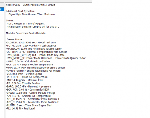

So the auto start/stop decided to pack up last week but it doesn't seem to be throwing any error lights on the button or grey A symbol on the dashboard.
The only thing I can find in the error codes is the attached image (P0830 - Clutch Pedal Switch A circuit),
Then the other day, the hill assist randomly decided that it wasn't going to work and threw an error on the dash board saying it was unavailable. Restarting the car made this go away and I haven't seen it since.
Is the battery on the way out? If it is, i'll need to get one sharpish tomorrow morning as the car is being picked up by its new owner!fault.thumb.png.e626c1050d07663229b35e2ea0e67927.png
It'll be the clutch switch.
The PCM won't know you're trying to do a hill start without a clutch pedal input.
The stop start won't be able to restart if it doesn't know you've pressed the clutch.

I did think this would be more logical than the battery. Is this an easy part to replace if I was to go to a Ford parts place tomorrow?

Interestingly although its reporting this error, starting the car without brake is fine, and actually I can't start the engine without first pushing the clutch like normal.
There may be two clutch switches.
