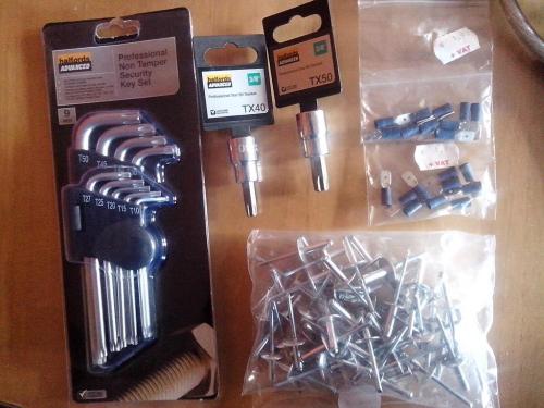

You can purchase individual sizes of Torx to fit a socket wrench from your local halfords store or similar

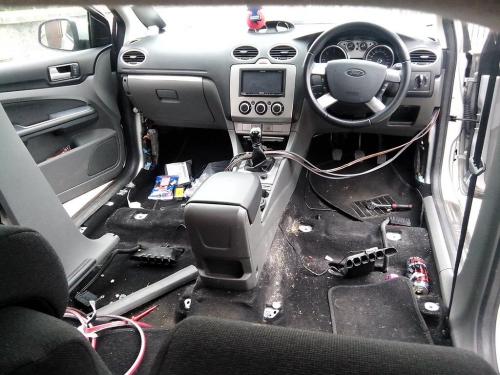

I've had all mine out before when upgrading the entire sound and entertainment.
