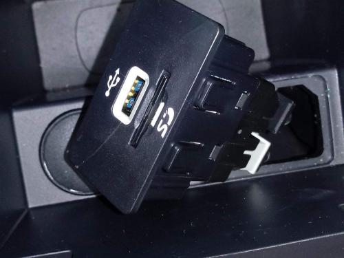

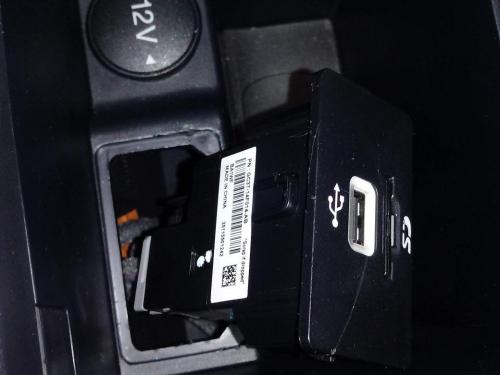

The car does have Sat nav, so the SD Card slot contains the maps. Today I tried a USB memory stick, with some MP3 files on. The memory stick was recognised and the track played fine, so the media hub appears to be working. I've only had the car since March, so have to get familiar with its features. The scratches were there when I got the car, but I have now taken out the hub, which is just clipped in, to see what's behind. Pictures attached. So now I have to look for something similar, but with a line-in socket on the front.

I don’t know when they changed, but by 2017 the focus had sync 3 fitted which uses a different media hub they didn’t have the card slot as the nav maps are built in. So that list won’t tell you what your car would have.
I’ve got a hub with usb SD and line in spare. If your wiring is correct just a straight swap

Hi Tommo17,
Here's a picture of the connections on the rear of the media hub. Basically it's a couple of mini-USB connectors inside a Ford moulded plug, plus another multi-way plug.
