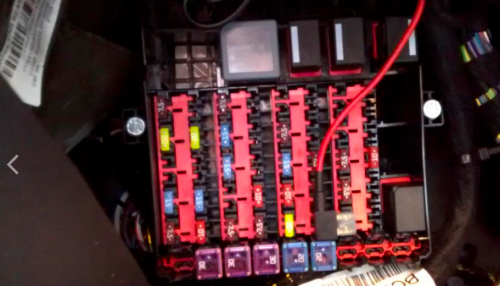

Hi all,
Can anyone tell me which fuse slot is safe for use with dashcam "Constant" power.  Also, is it possible / safe to use the empty Fuse Slots? ( if there's power in them ). thanks in advance.
Photo below is my fusebox type in my ST.

i took the liberty of checking each fuse slots to see which has Constant Power and which has ACC Power ... and hope this could help others.
DISCLAIMER: Do piggy backing fuses at you own risk. I will not be held responsible if damage occurs. Use multimeters and Choose your fuse slots wisely!.
O = Constant Power ( Power ON even tho ignition is OFF )
X = ACC Power ( Power turns On only when ignition is ON )
