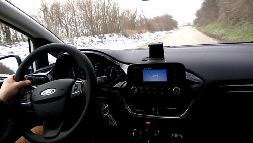

couple of days ago I encountered a problem with my audio unit , my audio unit is the same as the one in the photo below , while moving the audio unit refused to respond to any button , it didn't even switches off , it remained on , music was playing , I couldn't control any feature , and pressing any button didn't show any difference , the only way to get out of this was to completely park and switch ignition off , lock the car and then unlock and on again , but I've heard that there is a combination of buttons that you can simultaneously press to reset the unit so you don't have to park and switch ignition off , could any one please provide me what combination of buttons that needs to be pressed to reset the unit while moving ? thank you very much for considering 🙂
I think it's hold down power button and skip forward button.

Yeah spot on. Power and fast forward button simultaneously and hold until the unit goes black and it reboots.
I've had a similar lock up once, just froze and ignored any keys pressed.
