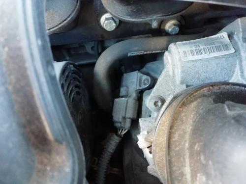

The fuel system Is pressurised so it's normal for air to escape when opening the tank. The PCV and hose is directly behind the intake at the front of the engine if you put your hand in the back of the of the right hand side of the intake manifold toward the block you will find where it connects it's quite tight in there but manageable to pull out. Mines below before I changed the pipe follow the pipe but easier to grab the PCV end on the right hand side.
